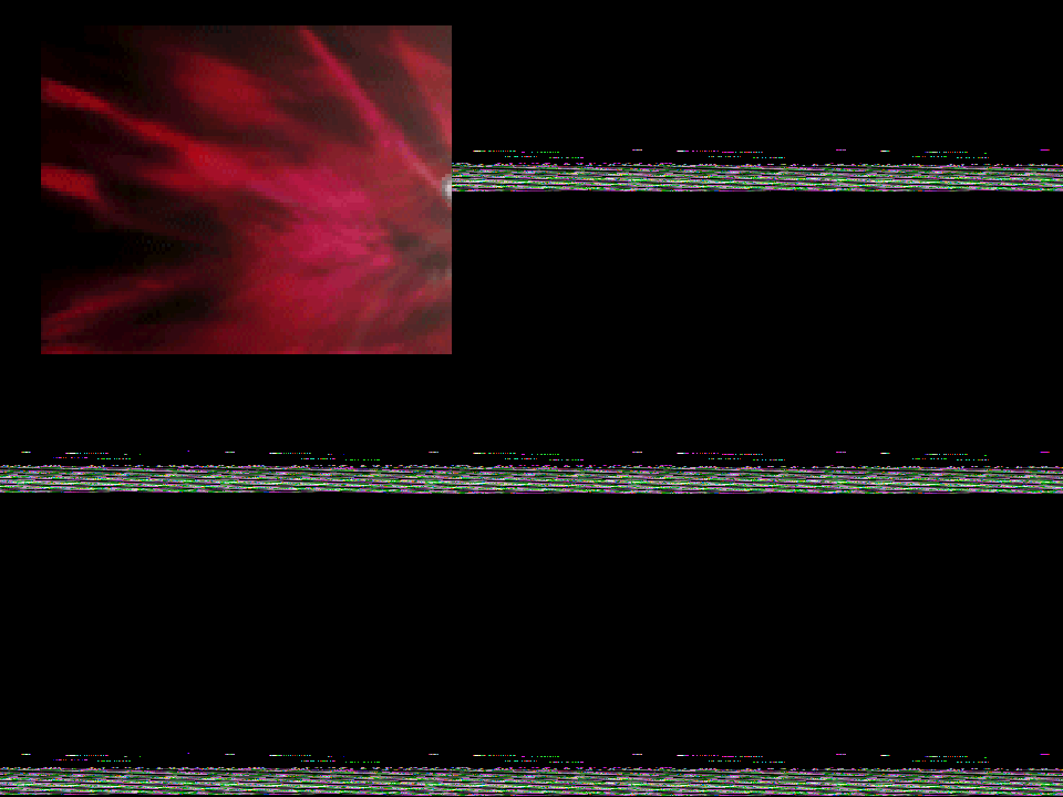

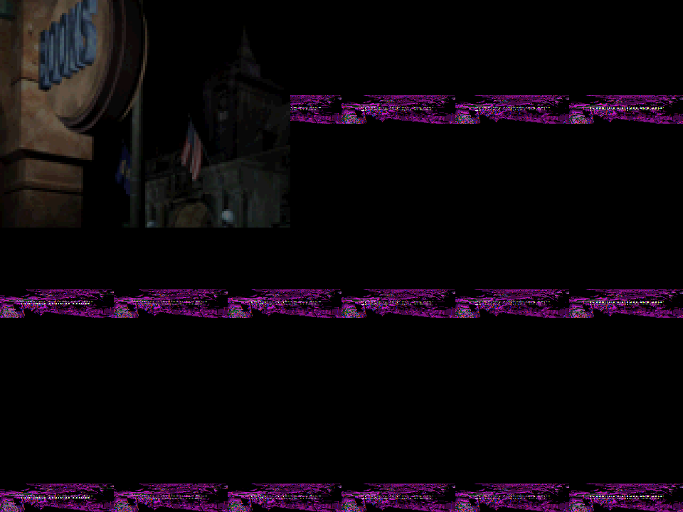

      I change the render res from the runcommand menu, from the default value, to 480X320 and the game start like in the pictures below.
      If i change the render res from runcommand launch back to normal value the game will boot fine.
      I start to have this problem after the new update of retroarch 1.8.. . I have the same problem and with other emulators.

        Can you try resetting the default retroarch.cfg file - which you seem to have saved/customized - with the default one (retroarch.cfg.rp-dist) and see if you get the same issue ?
        EDIT: rename your custom/saved config file and then copy over the -dist file.

          @mitu
          i change the old file with the default and everything works again.
          Thank you!

            I did a fresh install today of RetroPie 4.5.1(+the latest updates) to prepare a new sd card for backup and the same problem appear again after i change the render res from the runcommand menu.
            The only changes I've made in the RetroArch was the menu input hotkeys and the save time to 900seconds.
            I also noticed that the layout of the RetroArch 1.8.4 menu is not exactly the same with the version before the update and it have minor menu scalling glitches.
            Maybe a RetroArch bug?
            With the reset of retroarch.cfg everything is ok, back to normal.
            My English isn't at a good level.
              @windg said in Problem with the image after i change render res .:
              Not sure, most likely there's a change in behavior (if this configuration worked before) in a more recent version. The render resolution option in the runcommand launch menu it's not something that's often used - probably people just change the emulator's resolution to do a resolution change.
